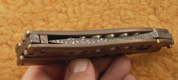

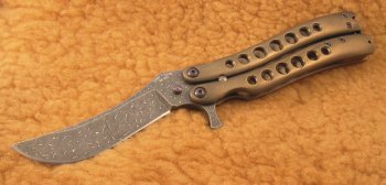

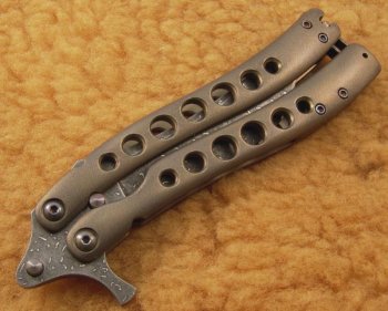

Here is on of my latest that gone north to Alaska. :D
T Terry Guinn Member Jun 22, 2010 #1 Here is on of my latest that gone north to Alaska. Attachments small 14.jpg 71.5 KB · Views: 65 2small 14.jpg 73.1 KB · Views: 37 3small 14.jpg 80.6 KB · Views: 35 4small 14.jpg 55.9 KB · Views: 33
Stoneman Active Member Jun 23, 2010 #2 man, those goblins are better looking every time I see one. I like the texturing you used on the latch and spacers
RafX Member Jun 25, 2010 #5 That's a beauty Terry! I really like the way the bronze color came out and very cool looking "speckles" on the blade! Those purple accents look hot bro!
O omegaman111 Guest Jun 27, 2010 #6 i know this may seem like a silly question but i am new to knife making and i was wondering how you get such colors in your goblin bali's?
T Terry Guinn Member Jun 27, 2010 #7 Thanks for the complements!!! omegaman111 said: i know this may seem like a silly question but i am new to knife making and i was wondering how you get such colors in your goblin bali's? Click to expand... The titanium handles are anodized, different voltages make different colors. The SS spacers, latch and screws are heat colored with a propane torch. The blades are etched in acid after masking the shinny spots. Thanks again,
