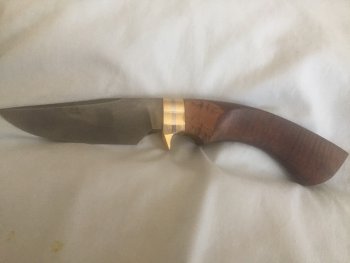

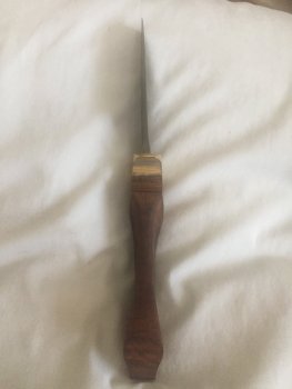

I've created a giant mess and need some help to clean it up. Last night I glued up a hidden tang knife. The blade was no big deal - 1095 w/ a Hamon. The handle, however, is a big deal - Ringed Gidgee that I bought from Austrailia $40 for the block and $40 to ship it here. In addition I have over 3 hours invested in hand carving and sanding the handle. When I glued it up (by the way I glued it with Brownells Acraglas epoxy) and clamped it up I didnt notice it but the blade set slanted to the side in the handle (see the photo, it slants to the left of center). Question is: Is there any way I can soften the glue and pull the blade back out of the handle and save the handle. I've noticed that Hardened Acraglas will soften when heated so I'm wondering if I can heat the blade with a torch and let the heat travel down the tang and soften the glue in the handle enough so that I can pull it out? Any other Ideas would be appreciated Thanks, Wallace PS Sorry the photos are so crapy.

perhaps a heat gun would work better than a torch, I think that there would be less of a chance of burning the wood. you can get a heat gun from harbor freight fo less than 20.00, I believe
OH NUTS! That very thing is what made me change my process. On a hidden tang like that, I cut a piece of guard material off a bar.....fit to the tang, finish the front face, and leave it in bar form. Then I cut the tang hole in a full block of the chosen handle material, make sure the mating faces between guard and handle material is gap free, then cover the blade and face of guard with vaseline.....and glue the guard/handle WITHOUT and shaping. Once the acraglas is cured, I clean off the vaseline, and everything is shaped/finished down as a single unit..... with LOTS of looking as I go to ensure things stay alined.
Anyway, In order to get it to release, it's going to require about 285F. You won't be able to do it with a torch or heat gun, without risking wrecking the heat treat.
I can't for sure say that this won't scorch the wood, but my recommendation is the kitchen oven. Pre-heat it to 290-300F, let it pre-heat, then put the knife in there for about 10 mins to start...... have your gloves ready, and as soon as it comes out, try to gently pull the handle....if it won't budge, give it another 5 mins, and try again. When acraglas "lets go", it's VERY thick and gummy.....so just be aware. Hopefully that helps.... personally my success rate using this methodology was about 50%.... which is one reason I changed my assembly methods as described above.
I've done what Ed described and it worked for me. Just be sure you don't exceed your tempering temperature.
Doug
