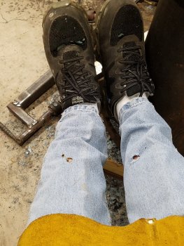

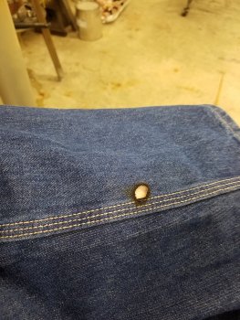

What do you ware to protect your legs while you are forging. My apron goes down to just below my knees. I have had more then a few jeans with burn holes in them. I can tell you they are not made of cotton anymore. Blend would probably be a good word.

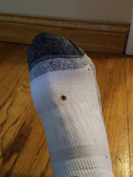

My FR pants are a joke. No more tennis shoes in the shop. Your right. Ed had the good idea.
