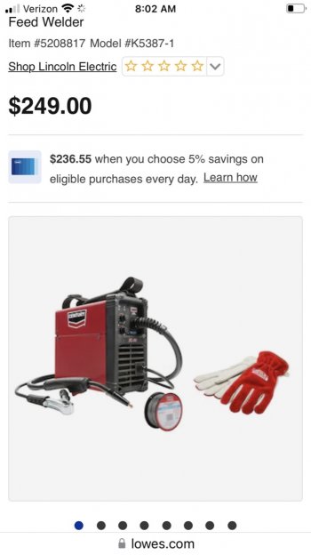

I’d like to be able to weld some items now and then - like fire place pokers, angle iron, etc. Not any heavy fabrication.
I’m looking at this welder, but would like to hear your opinions on getting a first welder. I don’t think I want to go with a gas welder so I’m limited to wire flux units like this one.

I’ve had a Century mig welder for probably 30 years and it’s been a great mig welder. Mine runs on gas too and the difference between flux welding and using gas is night and day. I’d get a gas welder if I were you opaul, for times when you want a really nice clean weld on something gas will do it for you.

Thank you. I could always go with a machine that offers both options. That way I could add gas later if I needed.
I have a mig non-gas unit that uses flux core wire and it definitely doesn't have the cleanest welds. You can grind off the "splatters" and it's a little less trouble/expense than having gas.
I usually just run flux wire because most of the stuff I weld is only for structural strength like machine stands and tree stands out in the woods but there is quite a bit of splatter and it ain’t pretty. I use welders aid in a spray can that helps some with the splatter but running argon gas makes a world of difference in appearance. The weld looks perfect with no splatter. The cost of a tank is soon forgotten when you compare with or with out.
My suggestion would be a machine that can do both! Like someone already said the difference between Gas and Flux-core welding is night and day! There is are also a few multifunction welders out there for less than $1000! That may be something to look into. The ability to (eventually) TIG is a fantastic option!

I’ve used flux core, and I wouldn’t recommend it to anyone to use on its own. When you use a shielding gas with it though, it can make some very very good welds. If you are going with flux core wire feed, I would look for something with the capability to add a gas shield. If that isn’t an option, a stick welder might be a better choice. My flux core welder made exactly one weld, and I returned it to the store and got a stick welder. It probably would have been ok for doing sheet metal, like body work, but it wasn’t something I was happy with. YMMV.

The Forney you referenced may serve your needs well - I'm not that familiar with it. Seems to have good reviews on Amazon.
If I were buying my first welder and didn't want to spend a lot - I'd shop Craigslist and pick up a good used Miller or Lincoln. I see a lot of MIG welders on CL at fairly heavy discounts.
