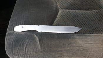

I finally got to cutting metal this morning before work. At least it's a knife shaped object at this point...
My calipers seem to have gone missing, but by a ruler the stock is about 7/32" thick.
12" OAL
Blade about 7"
Actually made from a flat HF pry bar. I know I'm taking a chance on the steel, however I'm looking at it as a learning experience, really more to get a feel for how to do all the grinds, etc. So if the steel isn't really up to par, I'll be able to live with that...
This is basically a rough profile, I have several areas that I need to clean up and smooth out, and so on. I thought it looks pretty good for about an hour or so with the angle grinder.
I'm going to have lots and lots of questions as I go along, and I'm looking forward to learning from the experience of the members here.
