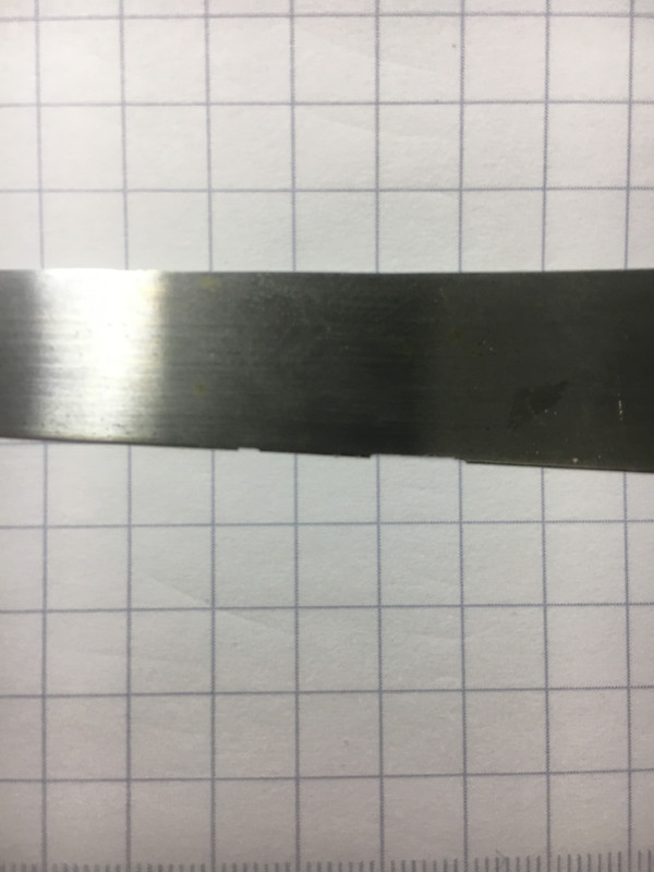

I had a fillet knife I made from 15N20 returned to me that has chips in the edge.
I have done the brass rod test with quite a bit of pressure and chopped into a piece of oak lumber and cannot get the knife to chip or deform the edges.
I've even push cut into the oak and twisted the knife with no edge damage. The blade is .010" thick behind the edge bevel, so I would think these tests would show a problem, but I'm not finding what it is.
I'm at a loss here as to where to go with this blade to try to fix it. At first, I thought I would remove the handles and re-temper the blade at a higher temperature. But, not being able to reproduce any chipping, I'm not sure if that's the right step.
I was told they were using it to cut up fish and noticed it wasn't cutting like it used to. I will be making a new one to replace this one, but would like to fix this one for him also. Any ideas?

I'm following this with interest. In looking at the photo it appears that the damage area are angular (almost squared at the end of each damaged area). I hope you can find out the cause. I'm in the same thought as J. Doyle, it seems 'just fileting' fish would not have caused this issue.

That looks familiar, I made a test knife out of 1084 with a standard heat treat. Ground a zero bevel edge. The knife survived, the brass rod test, a couple hundred cuts on sisal rope, chopping wood and antler. If you have tried to chop antler it is very hard on knives. It failed when I clamp a machine screw in a vise, and tried to remove it. All the jagged edges are from the corners of the screw, trying to remove it several different times. The knife performed amazingly well until the screw. I'm not saying that's what happened but it looks really similar.

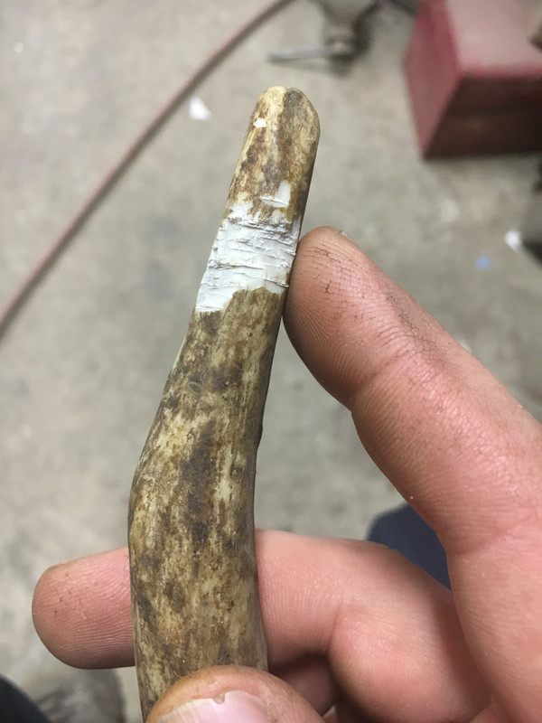

After reading Ty's post, I grabbed an antler and did some chopping. I was able to produce one small chip. I reground the edge and sharpened it up and chopped more antler. This time I got some very small edge deforming, not chips, the edge was pushed in.

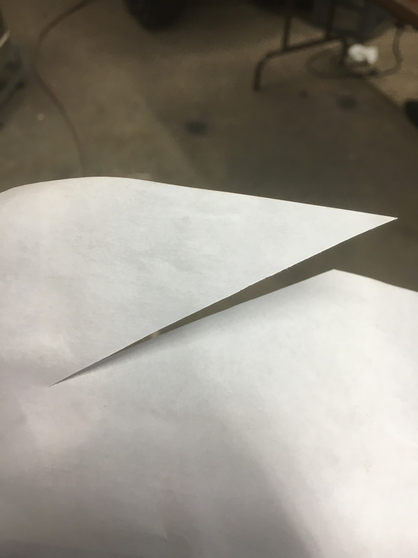

Even with this deformation, it would slice paper cleanly.
Could it be that the edge is too thin? I put the mocrometer on it and it's .008" behind the edge.

Evidence of a pull through sharpener especially those carbide ones with the rectangular v’s? 0.008” will need care and hard steel thin steel and pull throughs dint go together well...
I would just regrind the whole thing to 0.01” and return, that is not a flaw, it is an approbriate edge response to some torque... i am assuming it is not the day after delivery

My thoughts exactly. This looks like a pull through sharpener to me.
I also expressly tell my customers not to use a Steel on the blade. A Steel is fine on a 58Rc european kitchen knife but has no place being used on a thin 61-62Rc blade.
This knife was sold about a year ago. He did question me on how to sharpen it as he couldn't get it as sharp as when it was received. He uses the Lansky sharpening system. I've never used one so not sure if that is an issue, I always use a diamond steel.

It appears it was torqued laterally, probably against bone cleaning out rib meat. If they were cleaning fish, some guys cut through rib bones and if the fish was big, I can see it stressing an edge. I wish I caught fish that big. Some edges fail. I'd grind the chips flush on the edge and resharpen it and send it back since you have tested the steel fairly well. It's a 5 minute repair. All you are out is postage.
Since you are seeking feedback on what might have happened, with out seeing it close up, I'd guess it was sharpened to a very thin edge and it couldn't take the lateral load when it hit bone.
