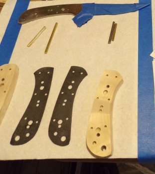

I'm finishing handle scales I cut from birch burl. I got some radiating lines but no curly grain. I barely sanded through a hole in the front with black epoxy in it. It looks like someone just dabbed it with a sharpie. I thought that's what really happened until I finally figured out what it was. I can barely see it, but it's there.
Anyway, I want to dye the scales black to hide it, but I don't want to lose the radiating bright lines through the wood. It seems like the lines would still retain some brightness but I thought I'd ask first as I sure don't want to lose the overall effect.

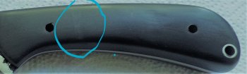

I decided to give it a shot. I don't see the radiating lines anymore - they had a different tone with one light coating but after a process of sanding and coating (about 4 times), overall they're gone. I can get one to come back but with the black dye it looks like a water mark, just a grey streak, not glamorous at all. But the black handles look good still.
I think radiating lines are more dense. Any other color might have worked. I hoped for the look of some woods after they've been stabilized, but it looked nothing like that. I would just stabilize in the future or use lighter dye.

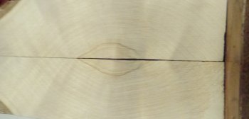

I wasn't going to put up a picture, I've already posted a lot of junk. But if you want to see, here's the shot. I circled the only spot where a line tried to show up. It's a rough finish, flat black. Going to peen brass pins in place next, clean everything, then wax. Unless I decide to take it all back down to 80 or 120 just to see what I can dig up.
Here's a couple shots of what it looked like before. The middle pic catches the light well. the last pic is the bookmatched pair.
