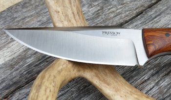

Not sure if the picture will work but here is one I did with a 400 grit cork finish

Justin, how do you get such a clean line from your bevel to the flat? I haven't used a cork belt, but when using a scotchbrite belt, I get stray marks all over. Does the cork belt not do that, or do you have to mask the flats?
John,
It's alot easier to get with the cork belt, I have tried it with the scotchbrite as well and its about impossible. The cork just dosnt have those stray hairs that slap the flats...I like them.
