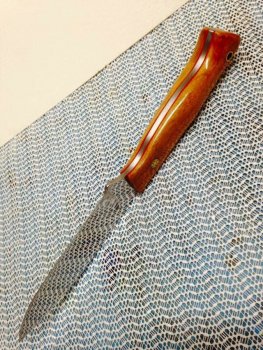

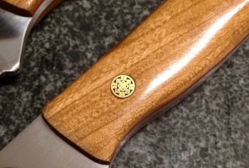

I did a set of three matching hunters in black cherry as a special request. The cherry tree was special to the family as part of the family homestead. They made boards of it when the tree had to come down. The customer wanted to use the wood as handles to make heirlooms and the figure wasn’t important since the wood was special to them.
I used red liners as a play on cherry. I wish I’d known about Anthony’s tip for getting more color into the wood. Luckily the wood was already many years aged. Tru-Oil also darkened it enough to make the grain pop.
