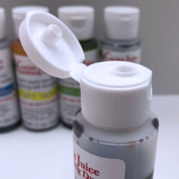

Late to the party again but I always fill voids with epoxy, mixed with color or dust from the offending wood! Mixed right I will guarantee you ain't gonna know the void is there! There are voids in almost any wood. When I made cabinets and custom furniture I have filled large voids and made then look like the grain or a knot!!
For mixing the color to match I have used oil based paint, model paint, stain, but remember you only need a drop or two. I have never had a problem with any of those sources for color match. However I switched to this colorants from Cactus Juice site!
https://www.turntex.com/product/cactus-juice-resin-and-dyes/2-oz-dye-detail
The reason I switched is you can also mix colors to get that hard to get color!! You can also buy these at craft stores, Hobby lobby, JoAnns, Wallyworld, etc. !!
bodam
The one thing I've noticed when mixing dyes or colors to your epoxy or glue, is to use a very small amount. it doesn't take much. If you use too much color, you essentially "dilute" the effectiveness of the epoxy or glue.
I take a toothpick and just dip it in my color and use the toothpick to stir the epoxy. That usually gives enough tint and doesn't seem to effect the integrity of the epoxy, etc.
