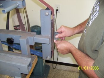

Ceramic Platen Liner
Bill Coye
Knife Maker
Just put the ceramic liner on the flat platen with JB weld ~
