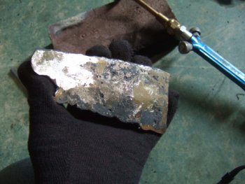

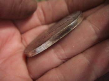

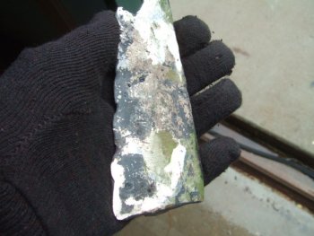

This is a piece I cast this morning , 45% fine silver and 55% copper . There are several types but I like the 45/ 55 blend .
This particular piece weighs about 12 oz. Used a fine silver .999 ingot and the rest good copper .
From this I will Hammer forge a Habaki and seppa for sword .
Another piece will be cast for Tsuba . Couple pics .... Bubba​

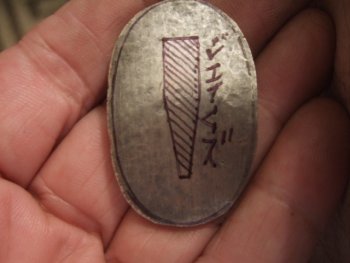

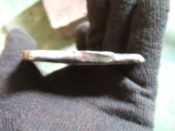

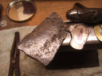

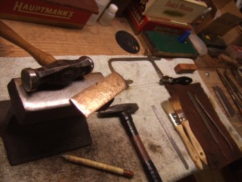

Here is a seppa (Spacer) I forged last night . Pieces of shibu already dead soft are expensive ,about same price as silver Mokume , that is unless you make it yourself . The secret to forging it without cracking is to anneal , anneal anneal as much as possible .
This accomplished by heating metal to cherry red then quench . Metal will be soft and easy to work . It does become work hardened so, the more you anneal the easier it works ...

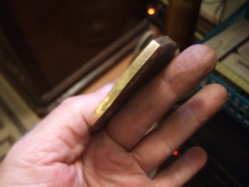

AS you work the metal to make thinner and elongate , it gets a nice golden color, kind of like black hills gold

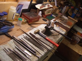

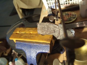

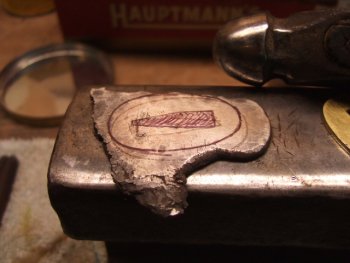

here is cut out Seppa ( spacer) Now I have to mic blade and make sure hole (ana) is nice and tight .... couple pics

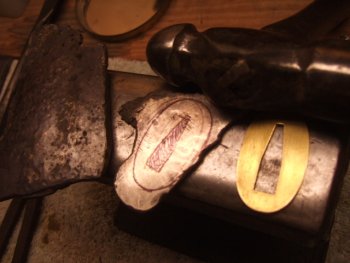

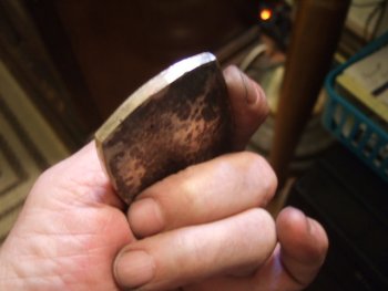

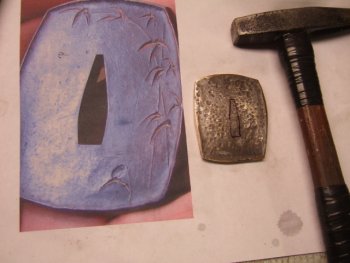

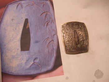

Here is picture of rough Tsuba for sword . Made from shibuichi 45% silver and 55% copper . Hopefully it will look like one in picture adjacent to the rough tsuba ..... Bubba

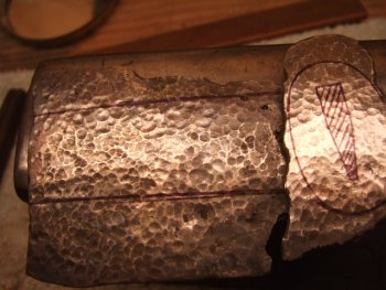

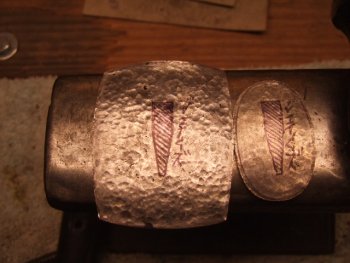

worked it down some more . Starting to get better shape . After this I will smooth out some with hammer , cut hole , and do some engraving of pine needles. Tsuba is very heavy for its size ..

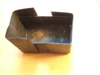

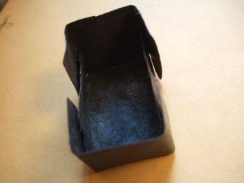

Thanks Ken , The mixture is 45% fine silver and 55% copper . I make molds for casting flat metal that can be worked from thin stainless steel. here is picture of mold . You can make them any size . When done pouring molten mixture into mold , let cool for a minute or two then Quench with cold water , The silver just pops right out .......... Bubba

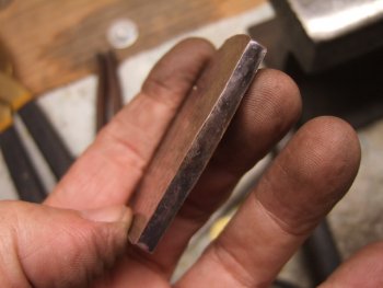

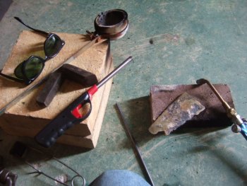

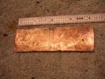

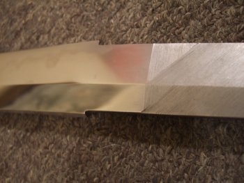

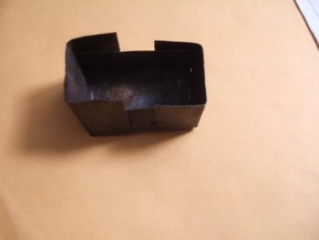

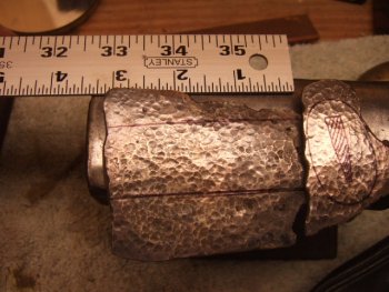

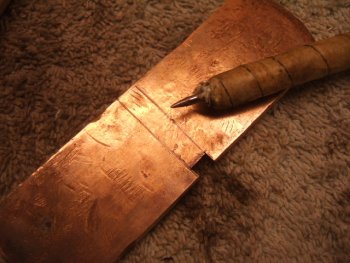

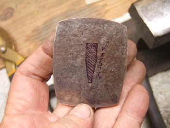

Casting and forging Habaki . This piece is approx. 1.25"x 4"x1/8" . Has been hammer forged and slot for sword has been cut . Tomorrow will bend habaki around piece of metal same thickness as sword. Metal needs to be annealed several times for each 90 degree bend , so bends are done 45 degrees at a time . Until you get horse shoe shaped piece . the scratch lines are where the bends will be . here are couple pics

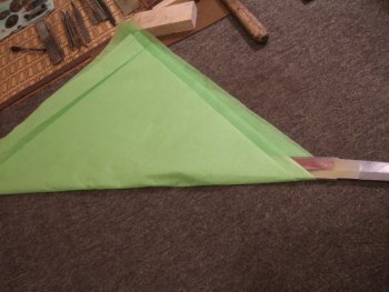

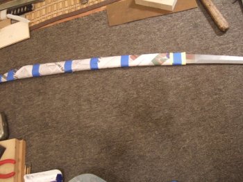

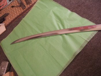

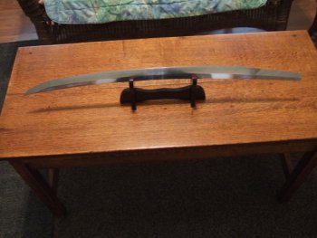

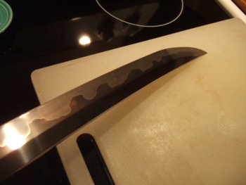

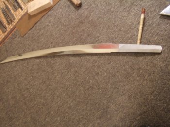

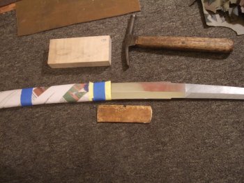

Ok here is what I do to prepare sword for Habaki . First I clean and oil sword then wipe off excess. Then carefully wrap blade with soft paper , when finished, wrap sword in Newspaper to make a scabbard ( Saya) to protect sword as you work on it . Don't want any scratches on newly polished blade .
