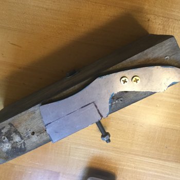

1090 steel 3/16 inch
Tools
Angle Grinder
1x30 belt sander
Drill Press
Block of wood and a bolt
Here is some pictures of my build and I welcome input.

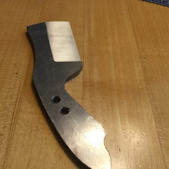

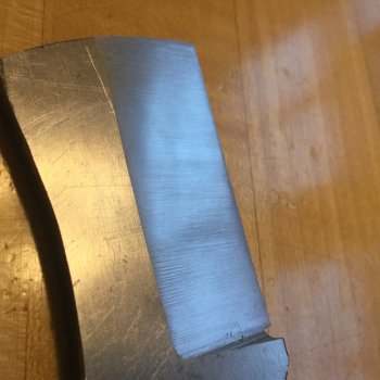

I left about a dimes width. I actually started at 80 then 120, 240, 400all on the belt.
The picture does show some imperfections, that's not a shadow, I'm not happy with them. I don't know if the previous grind marks are showing or some other weird thing. So my concern is that the more I play with it , the more chance of ruining it.
So what is going through my mind??? Do I leave it, go for higher grits by hand. Stick with 400 but do horizontal hand sanding. I know it depends on what I'm going for. Right now I woukd not sticking with 400 if I could get consistent horizontal lines. I still need to clean up the spine and all the way around.
