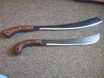

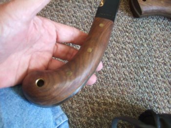

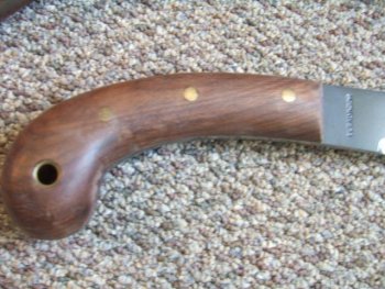

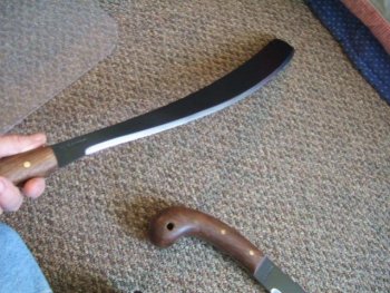

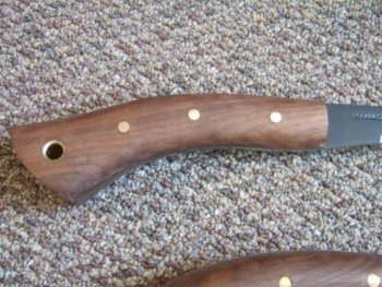

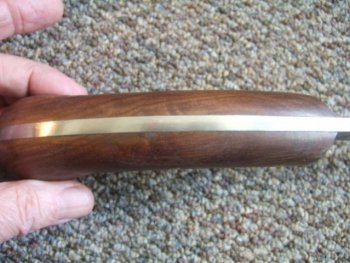

    Condor tools makes some real nice machetes , goloks and parang and so forth , all are made from 1075 and are a 1/4 " thick . Price 31.00 bucks each. they come with walnut handles and are some super blades for the money . Way better cutter than my cold steel Kukri. they actually came nice and sharp unlike other factory made machetes... I have both of them. Thought I would post a couple pics of these in the flesh.
    The quality of the craftsmanship is really good , walnut burled handles brass pins brass lanyard hole . These are some heavy duty blades and very sharp out of box. I like the 1075 which is basically sword steel . They are so nice I really dont want to use them , but thats what I bought them for . It would be extremely hard to make one like this for 30$ . I may make a copy using Aldo low mang . 1075 which means I can do a nice hamon on them. here are some better pics. Not only do the blades have a great edge , The spine of blade are polished , the edges are mirror polished . I couldnt make a blade for that cost even If someone gave me the steel..... the handles are big for you guys with big hands

    That golok out cut my cold steel kukri with no problems. And it was real sharp . the golok cut down a 4 1/2 oak tree this morning . Made a nice blister on my hand though . Its more like a hatchet .Its is a bit over a 1/4" thick . I personally like a slightly curved blade , more like a sword . But everyone is different . I think thats why axe blades are curved out ward , you have a smaller point of entry . I like the idea Of cpm 3V . I have a nice piece of that reserved for a sword . That stuff is expensive though .Maybe a little pricey for a machete?? I f you can find some 9260 I would use that, 2.5% silicon super tough holds good edge . Admiral has some . I think a good machete can be made from any good high carbon or medium carbon steel as long as its hardened and tempered properly . You have a lot of choices they are all good .. I also am interested in how it turns out .. good luck.. Bubba

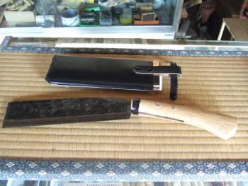

    Here is another style of cutter thats very good , Its called a Koshinata . Lots of folks have adapted this style of blade for cutting competition .
    They are almost 1/2 " thick . Bad ass cutters. The japanese used them on the farm . The blade style is ancient . Used for 1500 years or so.

    That thing is FREAKIN S-W-E-E-E-E-E-T!!!!!!! Mind telling me how the ferule is installed on the handle?

    I have the better one ( kukri) made from 1095. its a dam good cutter for sure .As for the The ferrule it is slid on the tang before handle is installed. Kind of like a japanese sword Habaki ( guard) They are made from good steel. They tighten it all up when properly installed and prevent handle from splitting. In the cutting comp you cant use a longer blade than say about 10- 12 " they feel a long blade would have an unfair edge so to speak.
    As you know, a longer blade has a much higher blade velocity which would be unfair . So they standardized it . Koshinata are pretty easy to make. I have some drawings somewhere , I got from a buddy in Japan. If i can find them will post them up . I also like to wrap them with some copper wire or thin leather cause the split in handle can be rough on the hands ..... Bubba .......... You guys got me all excited now , I guess I will have to make one also .
