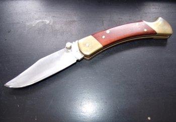

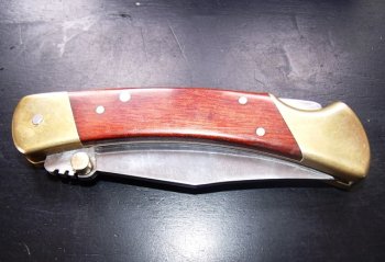

Bill Hubbell
Wow, where did that year go? I see I've been absent from KD for over a year. Even missed out on the Christmas gift exchange. I got on and looked at an old post and realized that I never sent an 'after shot' ofthis project like I said I would. I've been carrying this off and on for about a year. I am pleased with the end result (flaws and all). And my wife said shes proud of me- not because of how well the knife turned out, but because I said I was pleased with it even though it has some flaws. Anyway, here's what I came up with. Thanks for all the help from all you guys along the way of my 'knifemaking journey'!
PS: the anti-scale compound worked great.
