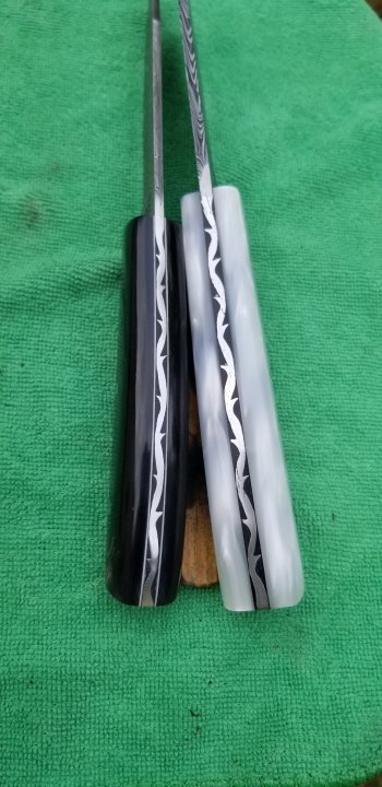

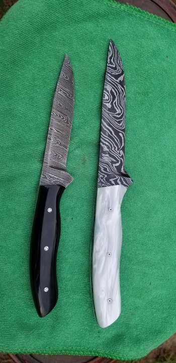

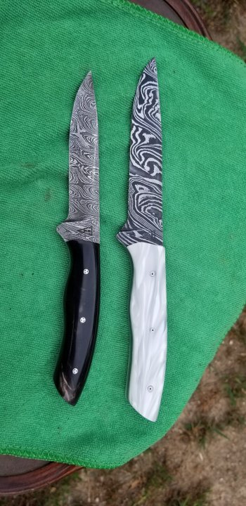

I just put some white pearl kirinite on a Damascus blade. Can I dip this back into a ferric chloride solution without it staining the kirinite? Unfortunately I do not have a scrap piece of the white to see it it stains it...

I don't know whether the acid would stain or not, but I've had good luck doing touch up on damascus by taping up the handle, and using a q-tip dipped in the acid to "paint" the acid on. I've also used those blue shop towels and wiped the acid on when I needed to do the whole blade.
mike miller
Cost the handle material in finger nail polish. Ferric won’t affect it then you can use acetone to clean the polish off when finished.

I've dumped kirinite in it and couldn't tell any difference, not white though that I remember, but I think you should be good

Thanks for the responses! I wiped it down with Acetone before I used epoxy to glue it on, I did not notice any distortion.
