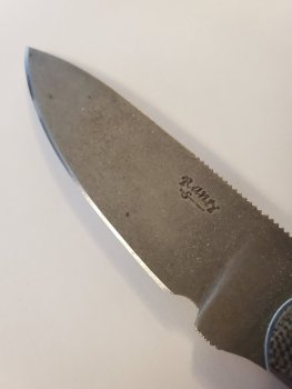

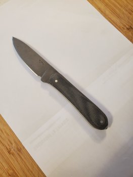

I use SS pins to clean my Pistol brass also. I built a larger hopper out of a 6" piece of PVC. I split a piece of 1/2" PVC and bolted it on the inside 180 deg to agitate my cleaning media. When I decided to try a "Stone Wash" on some of my blades I took out these pins and got a couple bags of ceramic media a touch of Dawn Detergent and some Lemi-Shine. Same recipe for my brass except for the Ceramic media. Heres the result on an EDC I built. Hope it shows up in pics.
