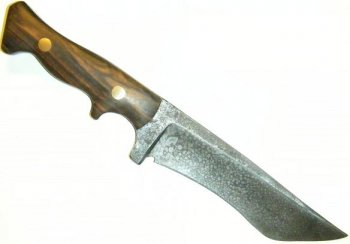

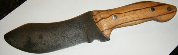

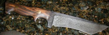

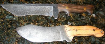

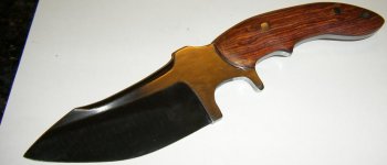

Nessmuk is 10",5" blade, antiqued finish, 5/32 thick 1075, Stainless 3/16 pins, high convex w/Marblewood
Persian style recurve is 12", 6 1/4 " blade 1/4 thick 5160 hollow ground and treated Sneaux finish, 1/2 inch brass bolts, w/Ziricote'
Broadhead is 9 1/2, 4 1/2 blade. 1/8 thick 1095, Hollow,false swedge,stainless 3/16 pins w/ highly figured Cocobolo from Nicaragua
None are sharpened yet .
All done on 2x42 and an older Grizzly. Scales on the large recurve and the small broadhead were hand sanded.

Can you explain some more about that Sneaux finish? I tried to google it, but only returned some shoes. Great work BTW.
Paul
Paul
LOLOL,.. yeah yeah, so Im a Coonazz.
For anyone who hasnt done this one ,...
Gunblue,steel wool, gunblue,finer wool, clean up.
Next take a household spray cleaning bottle(kaboom,409,orangeclean,etc) and mix a soulution of 60/40 straight bleach and apple vinegar(cause plain vin and bleach is pretty rank after a few hours) and holding at arms length-or maybe 2 1/2 to 3 feet away if in vise,and in one smooth motion give it a spray pass in one direction, dont get too close or youll wash out the pattern your making. hit both sides at same time if can and clamp,magnet whatever in place, Check the small bubble pattern on the blade, not uniform?- wipe rinse and do it again. You want a nice even spray pattern and no running drips.
Let sit for maybe 2 hrs on 5160, on 10xx series you may need longer depending on where you live(atmospheric cond's)
When you check it, it should appear to be rusting damascus looking, then you wash solution off with soap n water or baking soda, and steel wool again lightly to knock off any rust,.. and Voila'! you have a nice dark greyish weathered pattern, or if you made a single backed off further than arms length pass, you get the "Cajun Sneaux" effect :)
I have got to try that. I'll bet on O1 it would take a while longer. Thanks,
Paul
Another way, for a plain steel(unblued) to get a pitted gray aged look put the blade in a plastic container filled with bleach and vinegar and let it soak for about two or three 15 minute cycles, cleaning it in between cycles. It's merely an accelerated aging and pitting process, but it works nicely for heavy use stuff that looks like Dan'l Boone owned it first.
I did a huge 5160 bowie and treated it like this, looked like I found it out on the Sandbar in Natchez.
Another Knifedog who does a lot of this kind of thing with various methods is our own Raymond Richard.
