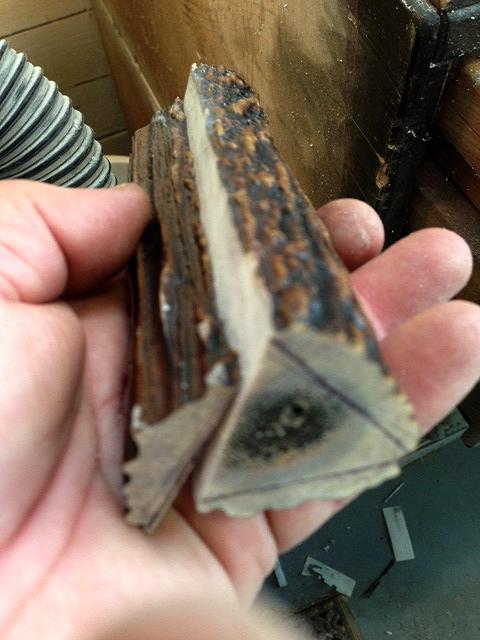

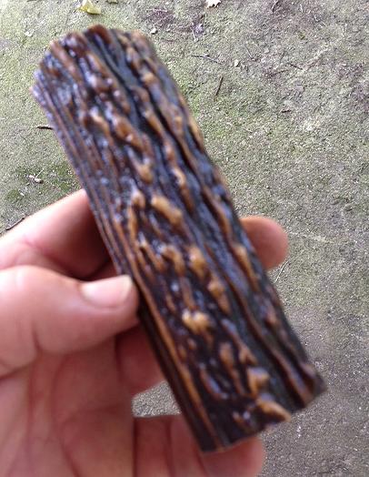

For those of you who have never seen this done before.
Just interesting.
QUI0MTgxRTY3RjBEQzhBQzY0REM6OTk0Y2M1YmIyMTU5MjBiYWI3MjdiYTNkYzZiYjdmZmQ=
QUI0MTgxRTY3RjBEQzhBQzY0REM6OTJkYTY1NTFhZGNjZGI5ZWMxMzYzODM4MWEwNzMyZjU=
QUI0MTgxRTY3RjBEQzhBQzY0REM6NTUzYTVlYWJjMjhiOTlkODViM2FmODZhZDhjYzk3NTY=
QUI0MTgxRTY3RjBEQzhBQzY0REM6NWRmMDI4MThkZDhiYzM0NDc3MmY4YTAyNjc0YjYyNGQ=

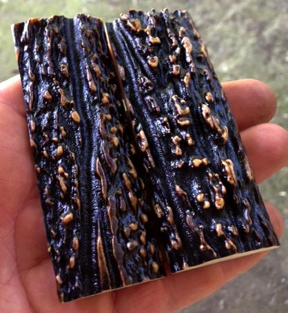

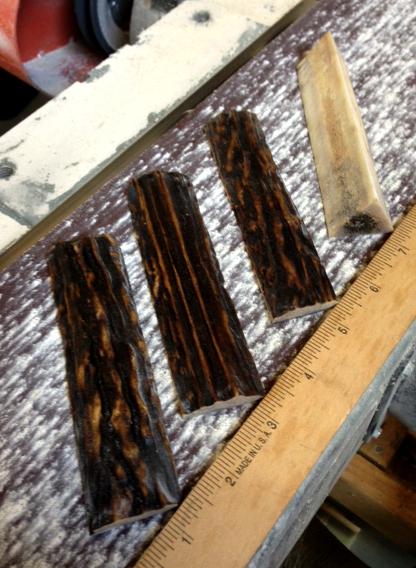

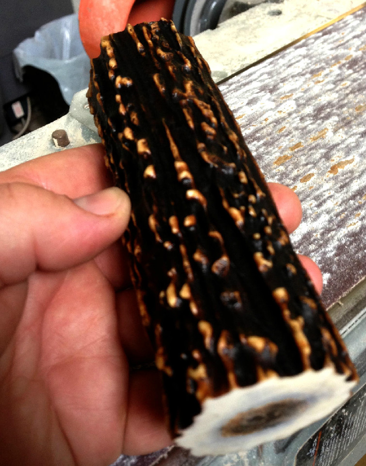

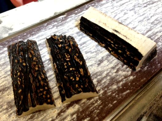

This Roll yielded a pair of scales and a spare.
The pair was a good enough match to keep together.
I'll have to cut another roll to find a match for the spare.

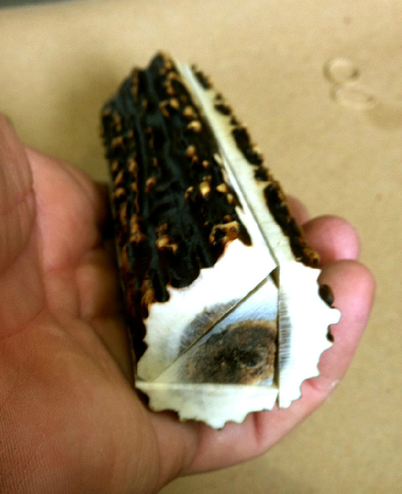

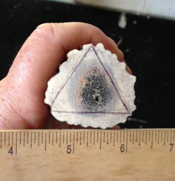

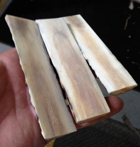

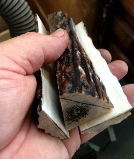

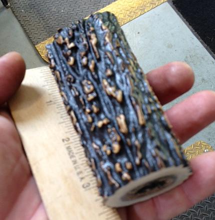

Here is another roll cut.
More detail in the steps taken.
QUI0MTgxRTY3RjBEQzhBQzY0REM6MjE4ZjgzNGMzZTVmZmRiYjAyODczYzdjZTQzNDcwMTE=
QUI0MTgxRTY3RjBEQzhBQzY0REM6NTM5ZTQ2MGNlN2EzYTRkZDAyZmQ0NGZiMDBmYmFiYTQ=
QUI0MTgxRTY3RjBEQzhBQzY0REM6MDhmYzY5N2Q0N2YyZGI2ZTljZDdlZWU2Y2Q1YmI1NDg=
QUI0MTgxRTY3RjBEQzhBQzY0REM6NDQ5MWY3NDM3NmVjZGQzOWVkZWRlMDVmMWU4MGEzNjI=
QUI0MTgxRTY3RjBEQzhBQzY0REM6YzFiMThmODExY2RhYTFmZjYwY2JhYmQxYzBhZjFjNTE=
QUI0MTgxRTY3RjBEQzhBQzY0REM6MmMzMjIzN2Y2ZmIzZGNhNTY4ZjJlYjM4MDBlYjcxYjk=
QUI0MTgxRTY3RjBEQzhBQzY0REM6YWMwOTc3ZTkzZmY4NjQ1N2U5YmU0NGFhMGQ3NDFmMWE=
QUI0MTgxRTY3RjBEQzhBQzY0REM6ZDE1OWE4ZjdkOWY0ODQzOTEyZTYwYTFiZDhhYWE1NjI=

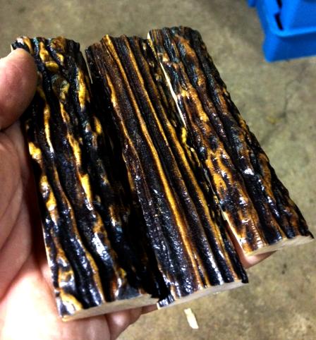

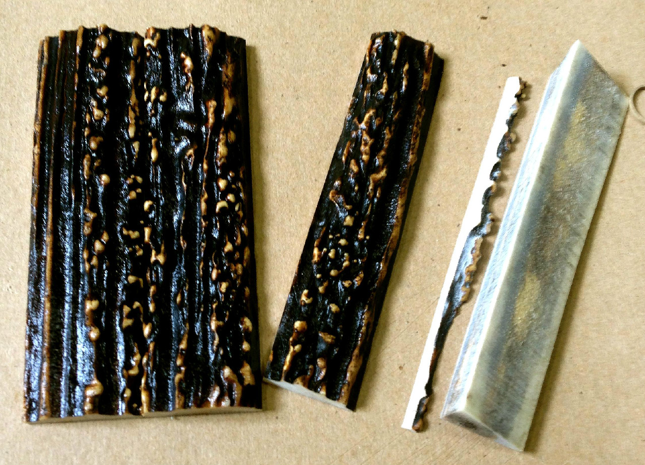

This roll yielded two pieces 5" x 1-1/4" and one piece 5" x 1-1/8"
I will have to cut other rolls to find good matches to get good pairs.

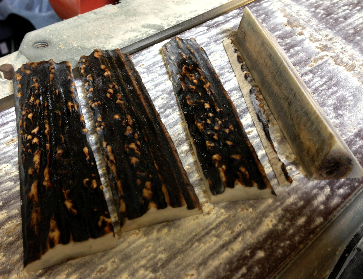

Here is another roll I cut today.

The center.
Good Question.
I cut the remaining dentine off the corners until all that is left is the hard pith in the center.
That hard pith is the very best, healthiest and vitamin rich puppy treat ever.
The dogs literally eat it up.
It's packed with all kinds of good things and it makes an excellent training treat for them.
Big, curved rolls that are not good for cutting make the best dog chew.
They chew on it because they love the hard pith.
While chewing, they get the minerals in the dentine, clean their teeth and gums, and get rid of some bad breath too!
