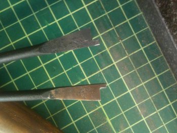

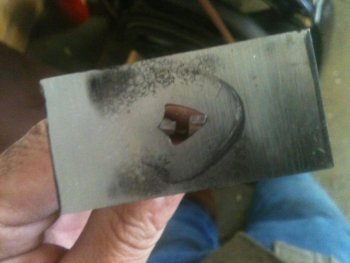

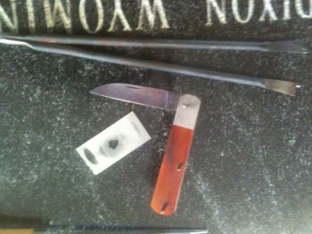

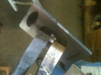

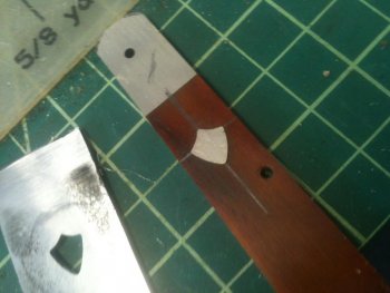

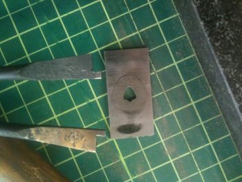

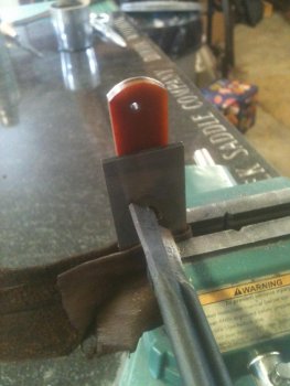

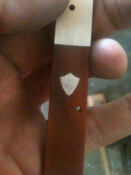

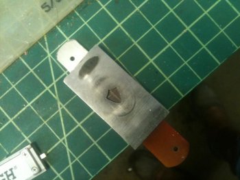

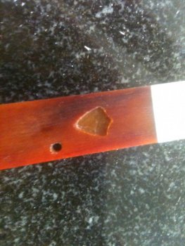

Haven't posted in some time. Haven't built too many knives either. 2012 was a terrible year as far as drought. Worked our tails off keeping livestock on feed what little of that there was. Blessed with a new son on my birthday back in November. Between that a filling other custom orders knives have taken a back burner. Anyway the following photos are almost a tutorial on using a two legged parser. Took a shot in the dark and it works like a charm. Not to sharp on the computer looks like the photos will load out of order. I think you will get the point. Hollow ground wharncliffe.

Sorry Forget finished knife photos

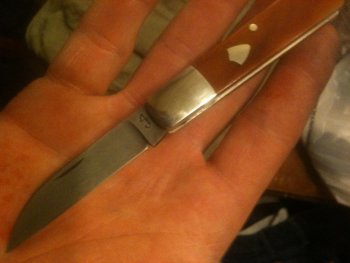

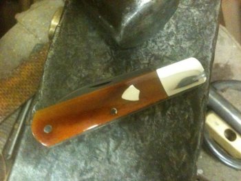

It turned out ok. I am my worst critic. Always striving to be better.

Ever since I saw one of these parsers I've thought of trying my hand a making one. Did you make this one yourself? I think it turned out quite well. How did you spin it?
Very nice knife. Clean design and great blade. The shield looks really nice. What is the scale material?

Yes I made this tool myself. It was made out of a 1/4 inch spring steel rod scavenged out of a baler. I discovered that a hand drill works just fine to run this. The handle is dyed bone.
Where did you get your template? I have always wanted to try this. What size is the template?
In answer to previous question. Maybe several. Template is made from hardened 1095. You can drill a hole or a couple then attack it with your needle files to get desired shield shape. Then harden the template. As some of you are probably aware the seems to be little no information on parsers. Funny you spend the better part of a day building a tool out of curiosity that performs a function that takes less than five minutes. For me it's all about the challenge.

.Say there, slatercreek, that was a great tutorial, and you came up with a super looking folder !!! Would you please give us a few pictures of the sparser itself? Frank
I realize it may be just a split piece of spring steel shaped , and the hand drill is that one of those old "brace" types or what? Sizes would of course really help. Thanks for any reply. Frank
In reply to Mr. Niro's question. The Parser is made from one piece of quarter in spring steel scavenged from an old baler. It was then folded in half. The legs of the parser were then drawn flat probably 3/8 wide. I am pretty simple minded though a brace would work better I just chucked it up in an electric hand drill. Slow and steady wins the race. To fast when you start usually results in the bone chipping at the surface. After that you can speed up a little.
