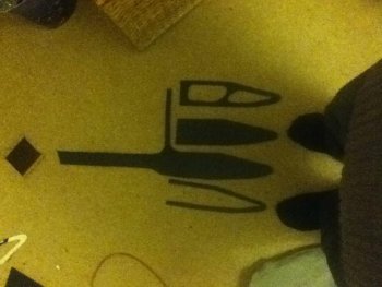

I got some money today and decided to spend it on leather instead of things I "need" so I decided to get the sheath designed and these are the templates for the sheath parts. I am not doing a foldy over type sheath, this one has a full welt because I think this creates less stress on the leather. I don't trust the grooves on the inside of folds really. I'm assuming that you experienced guys can work out how it works from the picture but basically I have the back of the sheath with everything else piled on top of it. If it doesn't work I will cry but I don't see how it won't. The rulers round the edge show how big the bit of leather is and apparently it is 8oz which I'm told is 3-4mm. It is black leather and the rattlesnake skin is a western diamondback I believe. School started again yesterday so nothing much will get done until February sometime when there is some kind or holiday. The brass for the bolster arrived today and there is a magic package in the post office. It's all very exciting!

I got the leather today, it is cut out at the expense of three craft knife blades (I'm 16 and in the UK, I can't get more). Still no snakeskin but I have a question, the sheath has four parts in the picture, the back and welt you can see but there are the two bits on the right, can I just put the snakeskin on the piece with the windows in it and put that over the welt or do I need a layer of leather between the welt and the window piece. If I do then I have a 3/4" thick sheath, not a problem but I am in the financial situation where I would like to save a few feet of thread. If you don't know the answer to this but know someone who does, please direct them here. The mother is quickly losing faith in my hobby so this is kind of on a deadline, hopefully I will be taken a bit more seriously when this is finished and will be allowed to buy a grinder or at least some kind of filing jig.

And in case you were wondering, I don't dress like that. That would be an air cadet uniform. If you are American I think it's like the civil air patrol or something.
Liam,
You NEED the leather behind your snakeskin ! This is an issue of safety so don't compromise.
Typically when using an inlay in a sheath like this a lighter weight leather is used to keep things from getting so bulky. Also, with your sheath that thick be prepared to break a needle or two while stitching.
If you've got a fine sharpening stone you can sharpen your craft knife blade in just a couple minutes instead of tossing it out.
Are your talking about exacto-knife style blades like this ? -
http://www.dickblick.com/products/x-acto-1-knife/
If so consider switching in the future to a standard utility knife like this-
http://www.harborfreight.com/utility-knife-3359.html
If I remeber correctly a pack of 5 exacto blades is about $4 while a 100 pack of double sided utility knife blades is about $15
Of course use what you have available at the current time though.
