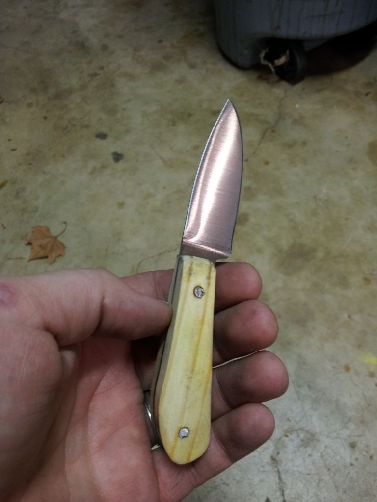

I just heat treated a batch of neckers and didn't like the grind on one so I decided to test it to destruction.
Blade steel is 3/32 O1 heat treated in my oven, quenched in peanut oil, and tempered three times at 400
Here is what the knife looks like all finished.
And here is the test knife. I had put a swedge on it but didn't like the way it came out and now that I've tested it, I really don't like it as it cuts into your thumb when you use it for leverage on push cuts. It has a quick pine handle with screws. I didn't want to spend too much time on the handle since it would be destroyed anyways
