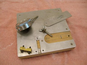

Brian, I think you won't have any problem building a RFI without a milling machine. Even with only a drill press shouldn't be a problem. Perhaps not exactly like the one on USAknifemakers.com but will do the job just fine. Dimensions are very general, and fit your use more than anything.
Take a look at the photo on your other thread - it doesn't take all the machining used on the manuf'd type. Just take a 3"X10"X1/2" chunk of aluminum (or steel). After making a pattern of one side liner, use it to drill a hole for the blade pivot, then another hole for the backspring pivot. Now with another chunk of aluminum, perhaps 1/2"X 1/2"X 1" to 2" long. Drill a hole in that to slide the dial indicator thru, with a setscrew to hold indicator in place. A couple other holes to fasten small block to larger plate. Volia - you have a RFI.

That is very true. I've done something similar with a piece of PG O1. It is a pain trying to do several knives in different patterns. I want an adjustable one.

Brian, Calvin's jig is a mind opener!!
Why do we need a mill when we can use 2 layers? :) The outer layer should be thick enough to ensure pins stability, way to go!
Scribing a line on the tang with the caliper, using the dial's number, is a very nice way to cut time when zeroing the spring positions.
