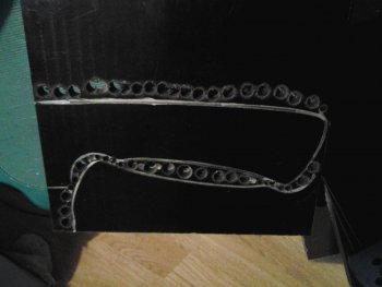

Any electric tools to cut handle material (G10, micarta, wood, etc.) other than band saw?
What i do is drill then either seperate with a chisel or a saw. But if there is a single efficient method that eould be great.
I have a scroll saw (brandless) but i think its not powerful enough and i cant find blades for it here, and tried once before with micarta, blade teeth didnt take it so well
Thanks
