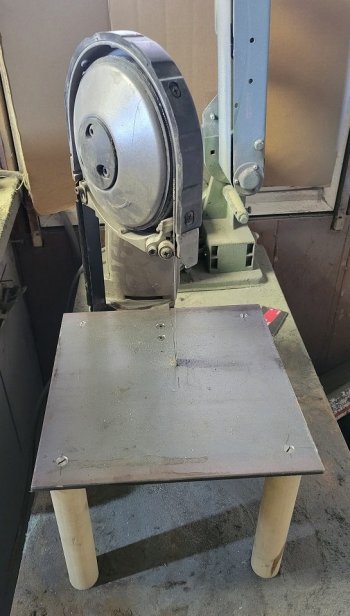

I made my own table for mine, but it's a pain to undo the table to swap blades because the saw is held to the table by the screws. The HF version looks like it supports the saw itself, so the table will be easier to take on and off. It looks like it will work well to cut tube and angle as well and get straight cuts!

Turn the table 180° so the blade slot is to the front - that allows the blade to be changed with table in place. When I first mounted my portaband to table I did the same as you, put the slot to back requiring table to be removed for blade change. that HF stand really does look slick, when my local HF gets it in stock it's gonna be hard to pass up.
