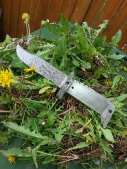

The "Dandelion"
Had a couple of pieces of an old (50's) rusty sawmill blade left and decided to make a quick implement for digging and cutting up dandelions from my lawn. (Thus the somewhat "mundane" handle shape and material)
As always, I never seem be be able to stop at just a quick down and dirty grind, heat treat, and put it to work. Nooooooo..... not me......
This one is 9 1/4" overall with a blade of 4 3/4" from tip to handle. The clip is as sharp as the lower portion of the blade. The texturing on the flats was done by nature (RUST). I darkened the flats, spine and exposed handle areas with cold gun blue.
Usually, someone will ask:
What is the steel?........... Answer.... I have no idea, probably something similar to 1070 or 1080 with, perhaps a tad of other alloys tossed in.
How did you heat treat it?............Answer... After I annealed it in my Evenheat, I profiled, ground, and soaked in vinegar to clean up some of the excess rust. I normalized 3 times, then soaked @ 1475° for 6 minutes. Queched in Parks 50, ran two tempering cycles at 400°.
Why did you use a sawmill blade rather than a known steel?........Answer....Because I can.
Hope you like................. Robert

Well, it started out as a "Garden Digger", but when I finished it, I said "Ain't-No-Way-I'm-Stickin'-This-In-The-Dirt"
I decided that someone, somewhere would get more use from it than I ever would, so I decided to let it go to a new home somewhere in hopes that the old saw blade would still be around for many years to come.

Not to hijack, but I have this weed knife that my dad made 50 years ago (he was a tool maker) and it belies weed digging prowess that he obviously was hiding.
The blade is very thin and flat (.072 O1, I guess) and handle is machined from solid aluminum, which is very clunky and uncomfortable but durable. The width is important when stabbing and twisting to pop out the weed.
I did a field trial (ran out into front yard and dug some weeds) to solidify my claims. Happy Weed Knife Building :biggrin:
