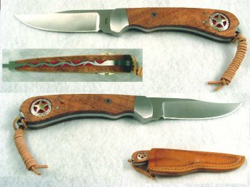

been looking and reading about file work along the spine............vine filing, rope work, arrowhead etc....................just wondering what do you guys use to fill in the void after knife is finished to make it all smooth, do you use super glue or what? or dont you bother?
I just fill the voids with epoxy as I glue up the handles. You can add color to the epoxy for an added effect, but use the color sparingly to avoid compromising the strength of the epoxy. I'm sure there are other methods that will work just as well. I've used testor's paint with good results. Here's an example...
