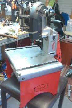

I took your advice and just used some hi-temp spray paint after an acetone bath. I think it turned out pretty good. :biggrin:
Wow, looks fantastic. I really need to get a SWag stand for a portaband I have sitting around. Might get more use that way.
