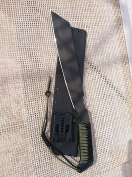

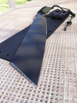

Knifejunky0311 Well-Known Member Apr 8, 2013 #1 My apocalypse knife Attachments image.jpg 157.1 KB · Views: 40 image.jpg 160.8 KB · Views: 41 image.jpg 158.5 KB · Views: 48
Knifejunky0311 Well-Known Member Apr 8, 2013 #3 18" oal. O1 tool steel 61hc. .260" thick. Duracoat od and blk. Kydex sheath with teklok blk. My apocalypse knife
stabber Knife Dealer Extraordinaire Apr 16, 2013 #7 Nice work. Cord wrapped handles do not work for me. Especially on a large Chopper
Knifejunky0311 Well-Known Member Apr 18, 2013 #8 Duracoat hold up ok if you add enough hardener to get a mild glossy finish. That matte finish tends to break down slightly over time
TacticallySharp KNIFE MAKER Apr 18, 2013 #9 Well done! Ever think about using the thinner Horse Mat material from Tractor Supply as a handle material for a chopper. I like it with carbon fiber pins and 5/16' CFtube for the lanyard hole.
Knifejunky0311 Well-Known Member Apr 21, 2013 #10 Never thought of that. If you can send me a link to what you are talking of. I'm interested.....
