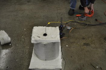

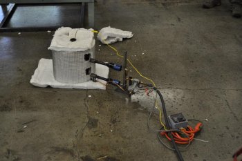

Michael, Here is a small salt pot setup MS Bob Kramer made for a heat treat demo at last years hammerin in Visalia Ca. It worked like a champ!
Scott
Scott
I love that thing...talk about frankenstiening a right together..I really need to read up more on PID controllers to at least be able to put together a rig like that.
