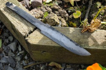

Decided to go with some plain mild steel for the first try. Hope you like it.
