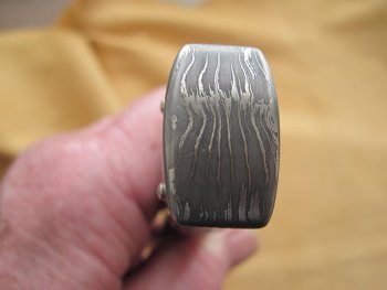

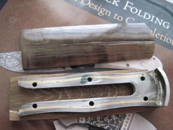

Not sure if this is a winner, takes some time did not have enough damascus for a framed handle, so took some .100" that I had and laminated it to a piece of mild steel, I brazed it and silver soldered on the back piece, would have used my mig but it died, you need to heat the damascus red hot to be able to bend it.

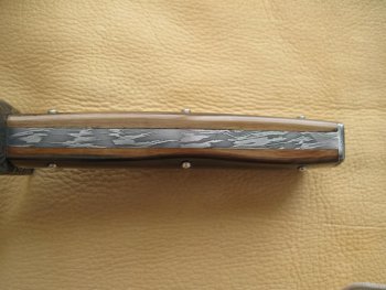

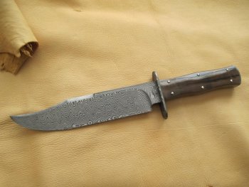

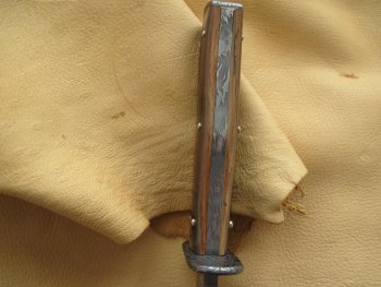

Mark, here is some pictures of the finished knife, it takes some time to do this, the 3 pieces are from thesame piece of steel, the back piece looks different it may be from putting a radios on it. Deane

Thanks for posting those pictures Deane,
It turned out very well, but how is the handle attached?

Mark, I use Devcon 30 min. epoxiy 2 ton grind little notches in the tang and in the frame, or you can drill thruew the tang and use some pins, will guarantee the epoxiy will hold, have taken one apart for a friend and one of my own, had to heat the blade until I could pry it lose with a bar. Deane
Mark, take a look at the back of the grind, I am getting old and cheat, that blade was done on my mill with a 4 flute cutter that takes round carbides, it gives the same radius on each side, have a magnetic chuck on pillow blocks I use, a little different way of doing things/. Deane
