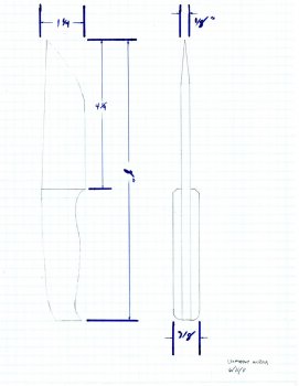

I have made the final draft of my first knife design.
OAL is 8"
blade is of 1075
thanks again Steven Janik for sending me the stuff for this knife.
Good start! I thought it looked a little chunky, but then I saw your thickness dimension is 1/8 (looks more like 1/4 in the picture). When I made my first, one of the things critiqued was balance. It was too handle heavy. Consider some moderate skeletoninzing. Also give some thought to how many handle pins and where they go. (Too close to an edge invites splitting the handle and too far from the edge invites movement later.)
Only other advice I could offer is don't let it get to you if it starts to look a little different than your drawing. Many knives evolve through their creation. I call it 'respecified design parameters'. :biggrin:

Looks good, my only advice would be to give the handle some contour on the sides instead of a flat slab look. That is what I was told of my first knives, and when I followed that advice, it did make them look and feel better. Other than that it looks great, now have fun making it come to life.

I agree. Don't be afraid to go with a more oval/eliptical shaped handle, or even to try and taper it slightly. It makes a world of difference with the overall feel and balance of the knife.
