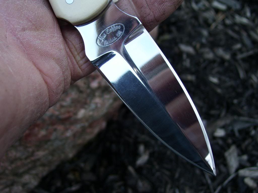

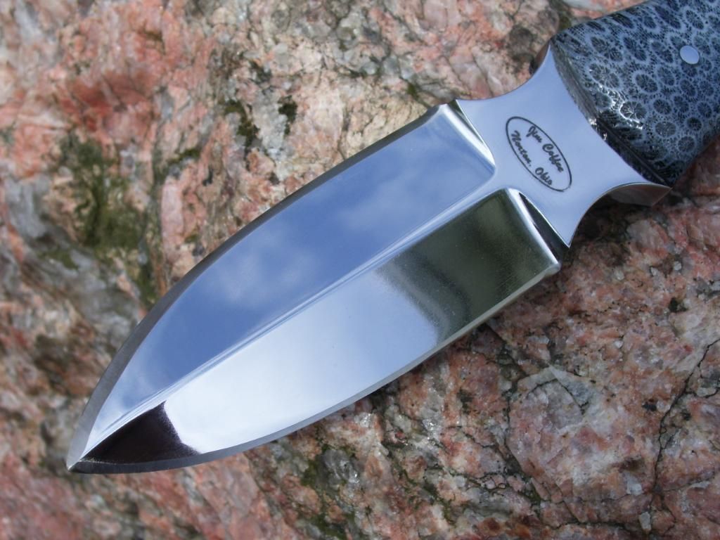

I make few Damascus blades and I usually differential heat treat them. I got into the habit of doing it this way because I think it gives better chance's of having a nice Hamon come out when I quench and then etch the blade.
LRB, Very nice Dagger's!
Laurence
www.rhinoknives.com
Thanks for the tips! I really like your work, specially the third one
I an working with THICK stock! But its all i have of the quality i want now. But i am doing this because i want to try it and hopefully will be fun and i'll learn few things too!
I have learned to leave them a bit wider near the tip than the design calls for, for some reason when I get warpage with dagger blades it's usually in the plane of the edges and the only way to fix it is to grind it out. A little extra width at the tang before HT also helps get things re-aligned if this does occur.
LRB, is that third dagger based on any particular piece? I always enjoy seeing your work, but that one is particularly fine, couldn't help but ask. Beautifully done as always.

Thank Justin. The first one was inspired by an original, but the other two just evolved as I went along.
