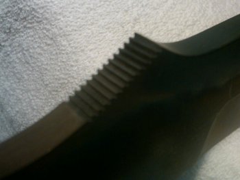

Jim I recently got a 20LPI checkering file and it does what I want. Here is a pic of a D2 tactical recently HT'd.
