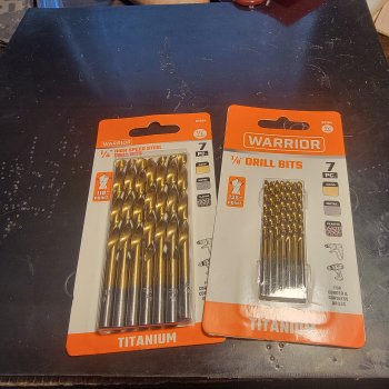

I was at Harbor Frieght today they had packages of 7 drill bits in common sizes that I use for making my knives. 1/8" and 1/4" they had others but I didn't think to look at those because I needed the 2 sizes I listed! Anyway if I remember the 2 packages of bits were around $11 with tax! I was getting ready to go to Fastenall to get these exact sizes. I'm sure they would have been at the very least double price if not triple! Obviously I'm not sure on quality yet but, they look decent?

A friend turned me on to buying plain tool steel Harbor Freight bits by the dozen in the smaller sizes that my fancy Darex sharpener couldn't handle re-sharpening consistently. I use them for 1 to 6 holes and toss them as soon as I notice the dulling. They make great try pins. Anything over 3/16 I buy screw-machine length and resharpen myself.

In my experience it’s by far more cost effective to just buy new drills for anything under 3/8 or so. If you aren’t too worried about your time the smaller drills can be sharpened but for the cost of new ones vs potential issues with badly sharpened drills it isn’t worth it most of the time.

I agree to most of what you posted. But I bought Drill bits and as far as I'm concerned they are a consumable item so I will be buying more soon. If they work decent maybe from them, if not I can always go to Fastenall and spend more! But I was there they were on sale I needed them so I bought them. Harbor Freight has upped their game as far as hand tools go. Many YouTube mechanics use them and swear by them. I would love to be able to buy Snap-On or Mac but as a hobbyist cost is a huge factor! 4 to 5 times the cost of a wrench so I can change my oil makes no sense! Unfortunately Sears/Craftsman is pretty much gone there are no middle of the road tools anymore. Their all made in China!

It all depends on your intended purpose and what you need out of a tool that should determine the quality of tool you buy. When it comes to drills I have some small HSS drills that cost less than $2 each. I also run small carbide drills that cost $80 a piece. The $80 drills are much cheaper when you put into perspective the way they are getting used. Punching accurate holes repeatedly into $200 stainless steel parts with the the $2 drills is next to impossible and costs a lot when they fail. At the same time that $80 drill in a little drill press will likely break the first time you try to use it where as the $2 drill would work fine.
So I buy name brand and I buy cheap “junk” just depends on the intended use.
I have have some anecdotal data points on those exact Harbor Freight Warrior brand that often goes on sale: 3/32" only used on annealed 8670 specifically in slip joint making process.
I broke 3 relatively quickly if not on their first use. Then stopped using them.
