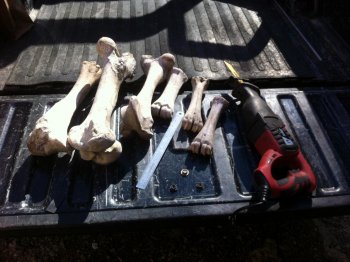

Went looking for deer sheds, got skunked, but came across a bunch of cow bones. Anyone ever use weathered cow bone for scales? I'm going to cut some it up and see if it's usable. Outside of course.
Just be aware that cutting and grinding bone doesn't stink, it reeks and can smell up things for days afterwards. Wear a respirator. You really don't want to be breathing in any bone dust.
Doug
Yeah, I used some bone that I've bought, just never any "found" stuff. I've got a 4x36 woodworking belt sander on a cart and in the past, I wheeled it over to the shop door to rough out bone. Once its on the blade though, you're stuck inside on your 2x72 and I agree, it'll stink up the shop for days.

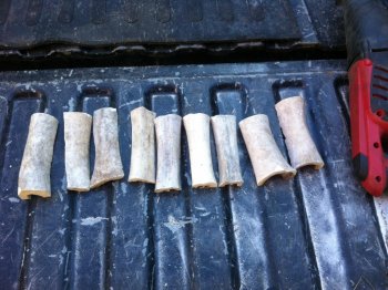

These bones have been out there a while I'm guessing. Some had cracks in them right through the flattest part, so I split those on the cracks. Not sure its worth messing with or not.

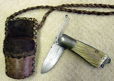

Back to the dye if you stabilize and dye at the same time the cracks fill and they will give the piece an awesome look because the cracks will stand out and give it a lot of character. Once stabilized and back filled like I spoke of they are solid as a brick bat!
This is a picture of a friction folder done by Daniel Winkler I pulled off of the net to show you what I was speaking of. The bone (at least I think that is bone) on this knife has been stabilized and I would guess dyed as well and as you can see the cracks in the bone really give the piece a lot of character!
