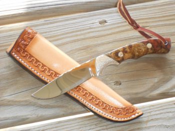

I call this my Texas whitetail hunter, The two tone amboyna looks good to me.
8 1/2 inches total length
Let me know what you think.

Sweet Hunter model you have made there!
That two tone Amboyna sure is some great stuff! I hope you don't mind,

Good looking chopper Laurence. It would be a long way to carry my whitetail to get you to chop it up though.

Eric I will take a picture closeup of some bolsters. That knife is gone yesterday afternoon. Most of the time

I used a 1/2 carbide burr in a dremel to bounce around on the bolsters to get the finish. Then I hit it on the buffer very lightly to finish them up, the buffer keeps them from looking rough.
