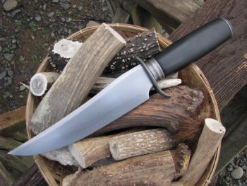

Other than putting edges on the blades these two are finally done. Its been years since I have used any of this African Blackwood so I gave it a try. The bowie has a 7" blade and is 12" overall. The guard is mild steel and the other fitting are wrought iron. Pretty sure the blade is W-5 but it could be W-2. It was a blade I have had around for years that I never got around to finishing.

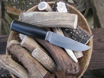

The hunter has a 4 1/2" 1080A blade and is just over 8". It has mild steel fittings. First pure stock removal blade I had made in several years.
