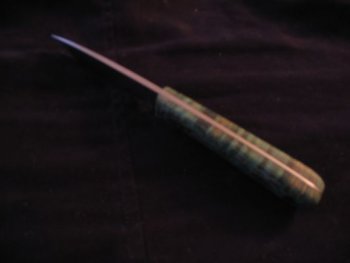

Bird & Trout/EDC Prototype
This is my version of a B&T. Hope you like it.
Specs: 3" blade, 3 3/4" handle
Blade: 1/8" CPM-154, fully tapered tang, full convex, hand-rubbed 2000 grit
HT: 59Rc with cryo by Peter's HT
Handle: green dyed/stabilized maple burl
Fittings: 1/4 SS Corby bolts and epoxy
Comments welcome, not for sale. I think the next one will have a thong tube where the back Corby is and the Corby a little closer to the middle. Other than that I like it... nice and light, and sharp as the dickens.
James, typed a nice message, got up to take the dog outside, and it was gone? Dang it. The below is just my opinion only, others will differ.
Will recreate as best I can. Won't comment on scales or pins, all are variable and can be modified by maker and customer as needed rather easily.
The top one, skinner, I like it alot, unique blade shape and good ergonomics it appears.
The middle one, GP, doesn't strike my fancy. Might be the black scales or perhaps a blade with more point would appeal to me?
The last one, BT, I like. I would like more curve in the handle, some drop at heal, just a tad, not much. Nice knife.
Good work James, I like them. Dozier

Nice work, they all have good appearance. I especially like the green dyed/stabilized maple burl . I`m fond of burl wood.
Thank you, Knife Nut. Stabilzed burl/figured woods are my absolute favorite handle material, either dyed or natural color.
