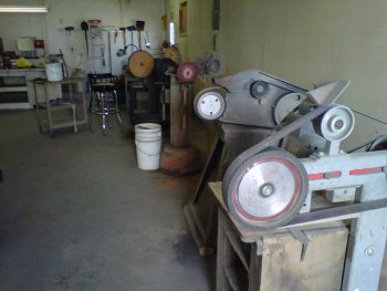

Many use grinder for different things. The second grinder is an old square wheel that I use for profiling and initital ginding. The closest is a Jerry Braggs grinder from California that I use to help finish grind because of its slow speed. The far grinder which looks like it has brown wheels is one Rick Menefee made with plywood and is now my major grinder. It is an 18 inch wheel and after slowing it down somewhat makes a very nice grind.
