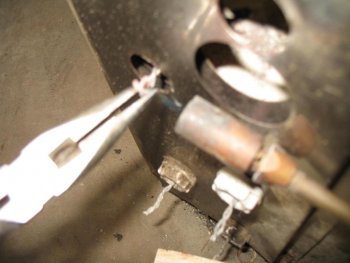

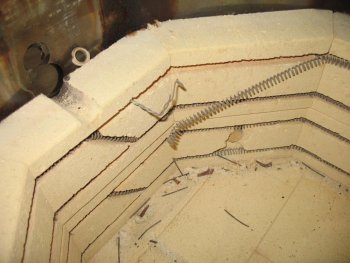

I removed the control box from the kiln so I could get to the wires to disconnect them. Where the heating coils come through the wall of the kiln they are twisted around the bolts they are connected to. They have to be straightened before you can pull them through the kiln wall. I used a small propane torch to heat the bent end of the heating coils and while they were red hot I straightened them. Next I went to the inside of the kiln and heated about the first foot long section of the coil and while it was hot I gently pulled it through the hole and gently removed the 1 foot section I heated from the groove in the firebrick. Again I heated about a foot of coil and gently removed the coil from the groove in the firebrick. I continued to do this until the heating coil was removed from the grooves in the firebrick.I didn't get many pictures of this because I was too busy playing with hot stuff.
First pics is showing where I started on the outside with the end of the heating coil. Second pics shows what happens if you don't heat the coils. I broke one.

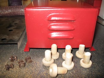

Here's a picture of the small stuff I decided to use.

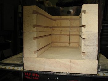

The kiln I used was round and I am building a square HT oven so I had to square the ends of the firebricks. After squaring the bricks, their dimension was 4 1/2" wide, 2 1/2 thick and 7" long. I wanted the inside of my oven to be 14" deep. I figured that would cover about any knife I would want to make. The inside width ended up 7 1/2". I stacked the bricks in the configuration I wanted so I could get the outside dimensions for my frame. I stacked two 7" bricks and two 5 inch bricks for the back. Then I added the sides two 7" bricks deep and two 7" bricks high. That made my inside 14" deep by 7 1/2 wide by 9" high. The outside ( adding 2 1/2" for the bottom and 2 1/2" for the top ) is approximately 14" high by 12 1/2" wide by 16 1/2" long.

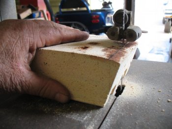

I used my bandsaw with an old blade to cut the bricks, they are very soft. It made a gritty mess of my saw and was a bear to clean it up. The rest of the trimming I did with a hand saw.

I used the top and bottom from the kiln for the top and bottom of my oven because they were solid pieces and easier to use than loose brick.

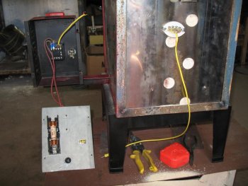

I made a angle iron frame to hold the bricks together allowing a little extra for the thin SS shell I scrounged from the kiln. I welded a angle iron bracket on the bottom right side of the frame to mount the control box. I made it long enough to keep the control box 4" away from the oven to keep the control box from absorbing so much heat from the oven.

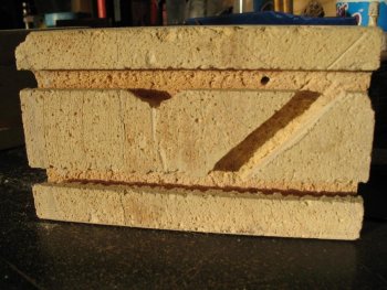

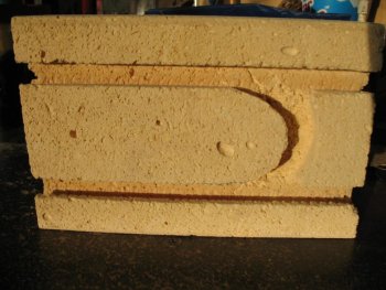

The grooves were already in my bricks from the oven so I didn't have to deal with that but I did have to cut round grooves from one groove to the other so the coils didn't have sharp bends. also I cut slanted grooves in the back bricks so the coils could transition from one groove to the other. Not sure how to explain it but you will see later when I show the coils installed.

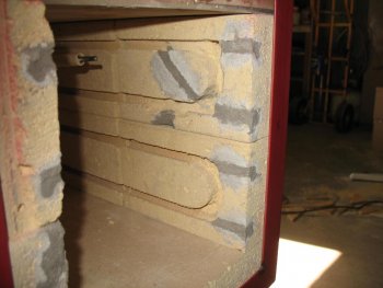

I mixed up some refractory cement and filled all the gaps and the grooves that weren't needed. Then I went to the back of the oven and drilled the holes for the heating coil connections. The stainless steel sheet metal I used to cover my oven came from the old kiln and it already had holes in it for the connections to the heating coils and the thermo coupler so I made sure this section went on the back of the oven. That way I didn't have to drill large holes in the SS. Next, from the back, I drilled 1/4" holes through the bricks from the center of the holes in the SS to the center of the grooves inside the oven. I can't seem to get my head wrapped around this project this morning, I hope I'm explaining things well enough.

Next I installed the control box on it's bracket and it will be ready for wiring the oven. I haven't wired the oven yet so I will add that later. Same thing with the door, I haven't had a chance to get that done so I will get on that today. I'm sorry I didn't get enough pictures of this project to make everything real clear. I would get so wrapped up in what I was doing and forget to take pictures. Here's what I have.

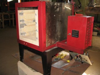

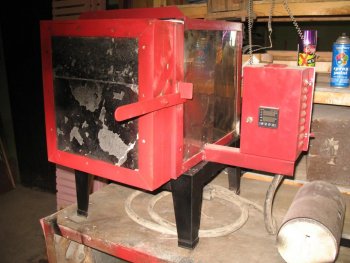

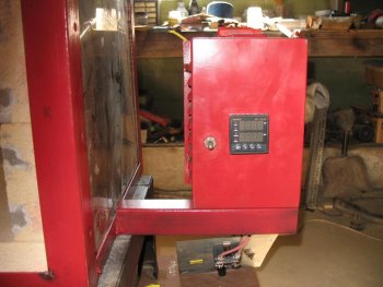

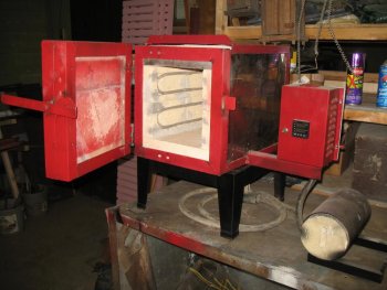

Well I finally got the HT oven finished. My buddy came over and wired it for me and I finished buttoning it up Sat. I copied the operating instructions from Aubers Instruments and now I'm trying to figure out how to operate the oven. I still have to get a dedicated 220 line set up for it.
I have about 20 fire bricks left over from the kiln if any one is interested. they have the grooves already cut into them. I have 3 final pics of the oven and I'm finished with this project.
If any one has any questions I'll do my best to answer them.

Larry that looks great let us know when you get it fired up. I ordered the same controls so I would like to here how well they preform. All my stuff is still in box's I just can't seem to stay away from the high lakes the trout keep calling me back.
The only thing I see missing is a heat sink for the SSR and maybe a cooling fan blowing through it. I also would put some sort of cover over the SSR and all that exposed 220VAC wiring.
I was considering a heat sink and a fan to help keep the SSR cooler and last longer. The SSR has a clear plastic cover and I have a cover for the back of the HT oven, just left it off for the picture. Also have a bracket to install to keep the wires further away from the oven. I have a pacemaker and am very careful around electricity.:D
