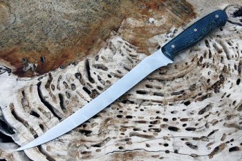

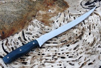

Here it is! After some help from the dog pound! I was able to make it.. Thanks so much guys, I promised pics and here they are!
Specs..
O1 steel, OAL aprox 14 inches blade aprox 9 inches
Stabilized and died teal, Sycamore lace handle with mosaic pins by JAKE.
Again Thanks for the advice and help.
God bless YA!

good looking fillet knife. How flexible is the blade? I have used a bunch of 01 and would not normally think of it as the "best" choice for a flexible tool....but I could be wrong.
Doug, you can send that beauty to me to try on some king salmon and halibut.....
Randy, that is one primo looking filet knife, love the profile and the sycamore, I thought it was micarta, would like to get some of that.
The blade is flat ground and I tested it to about 50 to 60* of flex. Its got good spring back and flex..
This is the second blade I made. The first I didnt heat treat properly and when I tested it, It was to way to stiff and snapped right in two at about 45* LOL Then I can to the Dog Pound and was advised to the best ways to work this steel!
All that being said, Its got great flex yet its stout. and will make a great working tool/fillet knife! I liked it so much Im starting a smaller version of the same basic design for my self..
On a side note, O1 is not very rust resistant. so proper care must be taken..
Thanks to all for the help and the kind comments..
God bless
