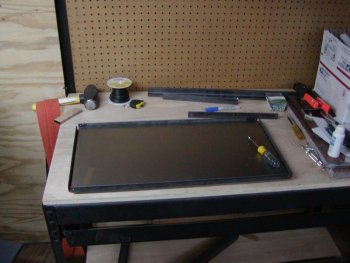

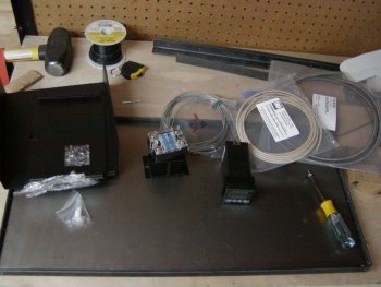

Well here are some pics of the stuff I have gotton so far,
