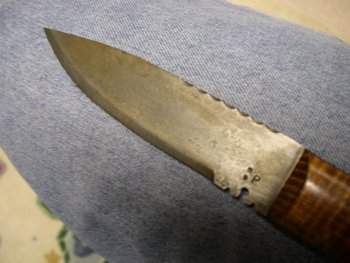

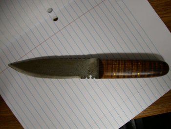

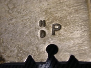

I was given this knife this weekend by my wife's uncle. The only thing he thinks he knows about it is the maker's last name was Parker and he was suppose to be from Michigan. I really don't think he knows. Help me identify this knife. It looks to be forged and the make's stamp is there. The initials MDP. It has unique cutouts at the ricasso and jimping on one side only on the spine. Any info is appreciated. huh1

I don't know about the maker but I'd say with the design and the spanish notch it was probably made for a fisherman or sailer

I have one similar to yours. I've seen them on different sites usually with different people making them. Check out Atlanta Cutlery and then Frontier Patch Knife. Track of the Wolf in Minnesota sells them also. They are usually listed under reproduction of a French Trade Knife. I've seen three places selling them,all with different makers. They usually cost between $22.00 to $28.00. Hope this helps
It's actually DMP, David M. Palmer. He owned the business and equipment for a while, but then when he retired sold everything to someone else. There are several outfits selling them.
They're cheap, mass produced knives for the rendevous crowd, basically fantasy "trade knives," although many of the designs sold are not historically accurate. They are usually thin high carbon steel of some sort, stamp cut, given a crude chisel or scandi grind, simple file work on the spine, and a "Spanish notch" on the ricasso, and then dipped in acid to give it a "patina" and some damascus-looking pits. They are not forged, and usually they don't even have an edge on them. I have 2 blanks with the DMP stamp I picked up a number of years ago from Troy Koval.

This knife was made by my father Marv Palmer from Hemlock Michigan. It was made in 1998 or 1999. My dad's knives wore stamped MP for 18 of 20 years. For 2 years 1998 and 1999, my dad stamped the blades with that mark that is on your blade. Reason being he was making the blades and shipping them down to my shop in Jackson Michigan where I would finish the knives. In July of 1999, my dad retired from knifemaking and I tookover the business. The stamp changed after that to DMP which stands for David Mark Palmer. I still make the trade knives, which are sold to dealers. The model you have my dad called a "Mackinaw" because the Museum in Mackinaw had him create the knife for display at the museum.The blade is not forged. The finish is created in heat treating with coal and anthracite. As far as makers of this style of knife, my dad showed 2 others how this was done. One of the makers is out west, the other was in Florida. And in reply to NJSTRICKER, the knives are not acid dipped. gun blue is applied after heat treating and buffed off with emery cloth. This help bring out the patterns that were created by the heat treat process. The knives are not "stamped out" , but cut out of annealed 1095 with my bandsaw.
