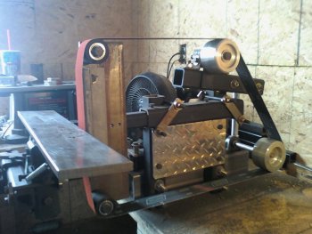

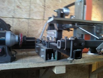

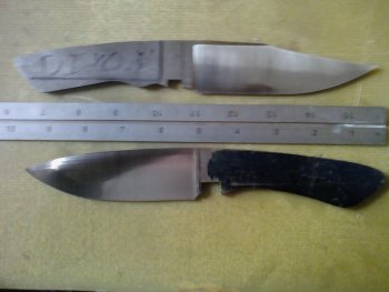

Here are some pics of my newly built NWG and a couple knives I ground today. Once again Tracy is a genius:D

man... you used some stout materials...and I like the boxing in on the uprights. That thing will never move. nice build.
t
That one is built like a tank...I like the way you used your bench grinder as the motor, great idea...2thumbs
It weighs a freakin ton. Everything is 1/4" wall cause thats what I could get for free. The bench grinder is variable speed so I figured what the heck. I only use one side of it anyway.
NICE! 3 things stand out to me.
#1 Everything looks better with Diamond plate!
#2 Much respect for using the buffer like that. I wish I had seen that before I bought my motor.
#3 That tool rest is fantastic. Show us mor of that setup!
Johnny
grinder looks nice heavier than mine . and x2 on more views of that rest Im wanting to build a new longer one simmilar to yours
Thanks for the compliments. The tool rest is adjustable past 90* both ways . It's on two 4 1/2" ball bearing door hinges and adjust up and down witha 3/8-16 set screw in the middle. The springs on each side hold tension on the table so it doesn't bounce. The table itself is 4" x22". These grinder builds are addicting. I'd build another one if I didn't have so many knives to make.
