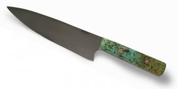

My daughter is getting married in a couple weeks (Blade Show weekend, but that is OK) so I volunteered to make a wedding cake knife and server. Here is what I came up with. The server thing was way more interesting to make. It is .070" 13c27 cold formed and then ground a bit to clean up the hammer marks. It was then heat treated to stiffen it up.
The blade is CPM154 in .125" thickness. I started with a flat grind half way up to thin it out then convex grind all the way to the spine. It's thin and sharp and took way longer than I thought it would but it came out OK. The pic doesn't show it that well but the blade is mirrored and the server is satin finish.
