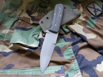

I used bamboo skewers once. They weren't perfectly round and left gaps around the holes. I did like the contrast against the black canvas micarta. I don't think I'll do it again.
