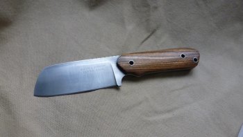

The piece is 1/8" O1 heat treated to non magnetic and tempered for two one hour cycles at 375. This took the most time except waiting for the epoxy to cure. I probably spent 45 minutes grinding the bevels and it certainly shows. My grinder is a Craftsman 2X42 modified for 2X48. The platen is just plain steel and is starting to get worn out. I used a battery charger to try to etch my name on it. Didn't like the way it turned out so I sand blasted it. This was the last piece of knife steel I had so this was more or less an experiment on how quickly I could get a knife together. Next time I'm going to take my time grinding the bevels and finish sanding the blade. Any critiques or suggestions are welcome.
Thanks
Jake

That looks good for a prototype. I just designed one similar for a family member. Let us know how the testing goes.
What was that you didn't like about the etch? I use a car battery charger and salt water to etch my blades. So far it seems to work good.
The etch actually worked but since the blade still had grind marks in it wasn't as bold as I would have liked. The battery charger worked good. The heat treat and the handle are what I intend to evaluate. I'll try to post results next week.

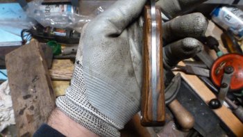

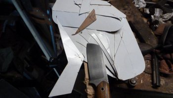

LRB thanks. Your assumption is correct. I moved the blade in and out of the little two brick forge for a few minutes. This was after the steel became non-magnetic. I know, still unknown temperature. I have an old pottery kiln waiting to be cannibalized for a heat treating oven. I tested the blade yesterday.
I like the handle profile. It's swelled in the right places for my hand and I didn't get any hot spots. For testing the edge I made a stropping wheel to get the blade wicked sharp. OK not so wicked the edge is hard alright. It took a while to get a decent edge with my bench stone. Other than hardening correctly I'm going to revisit my tempering. So I sliced through some notebook paper. It sliced ribbons of paper off. Another thing that slightly annoyed me was the paper getting caught in the choil. I'm going to delete this feature in future blades.

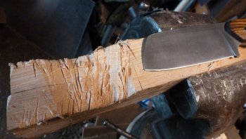

Next I tested the edge against a piece of oak board. I took a few chops at it. No edge deformation. Then I really went at it. Around 300 or so cuts a combination of chopping and slicing. Still no edge deformation. The handle stayed tight and was comfortable. I did not try to bend the blade it's designed as a slicer. I'm pretty confident it would have broken due to the primitive heat treatment. After the chop test I sliced through several pieces of card board and another sheet of paper. The edge is not razor, as in shaving sharp, but it sliced cleanly through the paper. The choil still gave me fits.
LRB thanks again for your comments.
Jake
