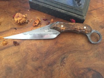

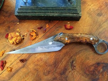

This was a really fun build and the Hamon turned out good. May do another one of these. Haven't decided on a sheath yet. What do you think, leather or Kydex? Love to hear your comments. Thanks,
Wallace
The specs are:
Blade material: W-2
Blade Finish: Satin Finish with an active Hamon
OAL: 9.5”
Blade Length: 5.5”
Blade Width at Plunge Line: 1 1/4”
Blade thickness at Plunge Line: .1875"
Handle Length: 3.875”
Handle Material: Stabilized Karelian Birch
Pins: 1/8" Stainless Steel
Handle Finish: Sanded to 1500 grit, Ca sanded and buffed
